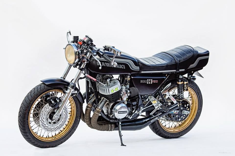

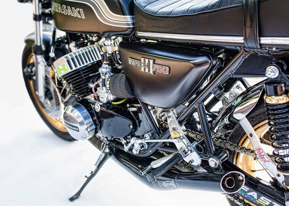

Here comes a message from Jörgen Lund in Norway about his H2B. /BR Hasse
Hi German triple friends
Some data on my H2
H2B frame. Think it is a bit stiffer than early frames, and the rake is 1,5 degrees steeper. 26,5 vs 28.
Swinger is a katana 1100, modified.
Hugger is from a Madura 1200. Modified
Front brake right caliper is genuine.
Buchanan rims, anodized gold, then powder coated cold, then swirled to get the ancient look, then powder coated clear.
Trued them myself, stainless spokes and black chrome nipples
18 inch front and rear.
Stock H2B front forks, but air pressurized and with progressive forks.
Lowered 30mm front, raised 10mm rear.
Front fender ZL900 eliminator. Grinded upper part of forks to make it fit.
160 rear tyre.
NOS John Tickle rear sets foot pegs. Looked 1 year before I found them.
Brown black painting, matt. Clear stripe on top and fuel tank. Gold stripes.
RB decals.
Motogadget mini speedometer, electronic with all monitoring lights. Odometer, Max kp/m, hour meter, volt meter, trip meter. Integrated into head light bucket.
Tarozzi handle bars
Self made oil tank with visible level meter outside right side panel.

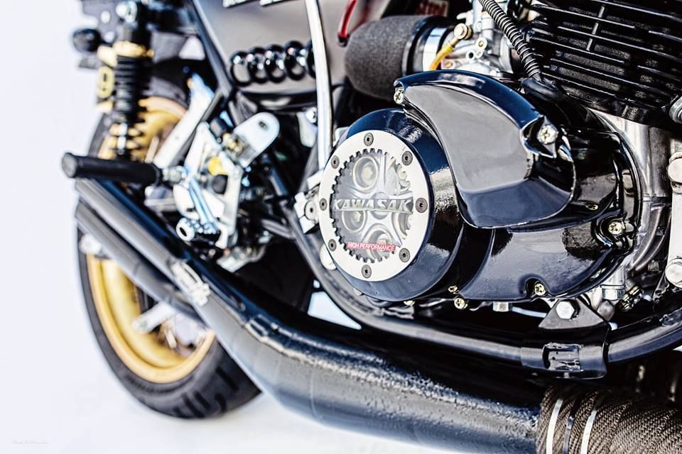

Self made windowed clutch cover
Self made electrical system. Led light under tank, green led light inside clutch cover
Modified H2C repro seat
HIGHLY modified repro H2R tail. Think I used 25 hrs on that one alone.
Engine:
Rubber mounted H2B cases. Ported to improve transfer tunnel entrance flow.
All 5 gears under cut
15 plate clutch
Jollymoto exhaust, highly modified to make the look I was looking for. Internal stingers
Wrapped headers, glossy black painting
Ported cylinders. 100’s of hours work in research, trying and errors. Almost gave up, but succeeded by modifying inlet, transfer tunnels entrance and rear boost port.
Power jetted VM38 carbs.
Zeeltronic adjustable ignition.
Toroidal heads, 130-135 psi compression to avoid detonation when engine is really hot. Like when full throttle high rpm 4.th and 5.the gear by passes. Long E-type plugs
Made by John Aylor after my specs. Comp MAY be kind of low, I still can deck cylinders 0,3mm to get even faster squish, and about 7 psi more compression. But run as is this season. Got 125 rwhp with those heads, but lost 2-3 hp all way prior to peak power due to lower comp. But detonation issues seems to be gone as I have done numerous 5.th gear dynoruns without cooling. My TTO temp sensors mounted between plug and head showed 170 degrees C. HOT
Piston clearance 0,1mm to avoid piston seizure. Wossners
The essential parts of porting is to get as much mass flow from crankcase and up to combustion chamber.
Then Blow down area is critical, as we want as low pressure inside cylinders as possible when transfers opening. Look at your transfers when removing a cylinder after a season. You will see they are black. That is made from exhaust gases. The more pressure inside cylinders vs crankcase pressure when transfers opening, the less flow and scavenging you get. And also hotter fresh charge.
BD area is critical for power. Remember that.
Inlet duration is not raised very much, as it affects the low and mid range power.
Remember the engine works as a pump prior to power band. But the pumping ability is bad. It only works from inlet closing, to transfers opening. That’s not much crankcase rotation in degrees, just think of it.
When in power band, and IF you got good pipes, the pipes run the show. The engine in fact works as a resonator now, not as a pump. The suction and supercharging of a good pipes is far greater than the pumping effect made by the piston. Remember that.
With stock pipes, it is crucial to make the piston pumping effect as great as possible, as they don’t make as great vacuum and supercharging as a expansion chamber. I gained more than 30 just by adding good pipes, (comes from more rpm off course, but torque also improved a lot) Power in HP is just Torque x RPM. Remember that. That means 80 Nm at 8500 rpm makes a lot more power in HP than 80 Nm at 6800 does.
It is also crucial getting the pumping effect as great as possible using expansion chambers if you want power prior to power band.
When IN power band, increased inlet duration (by cutting the piston intake skirt for example) increase peak power, but then the low end power is getting worse. Using reeds helps for low and mid range as the pumping effect increase. Using big reeds with effective rear boost port design, helps all over IF you are able to get the charge up transfers from crankcase.
Funny thing is, with milder porting (94 rwhp), VM34 and same jollymoto pipes, same ignition, my mid range were weaker than with my present heavy ported VM38 set up. Maybe my pipes were asthmatic, I don’t know.
All I know is when doing all the mods I could think of, power went up all over rpm range. So porting crankcase, inlet, transfer tunnel entrance including divider, raising windows a bit and highly reshaping rear transfers got me into the 120 range rwhp range depending on what pipes used.
I really want to try the K2tec tapered cross over pipes, as Ebos curves shows they produce a lot more power in low and mid range than with he using Jollymoto.
Those pipes must be absolutely fantastic!!!!!! But I can’t use them on my caferacer as they will be kind of ugly I think. So I stick to my own modified Jollymoto pipes. They do great in powerband, and acceptable in low and mid range.
Best from Norway, Jørgen
